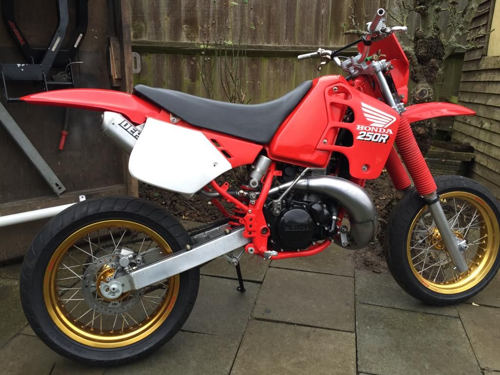

Post by d5aul » 02 Feb 2015, 21:33
A little update, side panels cleaned & painted, new front mudguard cut down & fitted & seat fitted, the seat has previously been re covered with extra sponge, I will be looking at re covering this in the original red at some point.

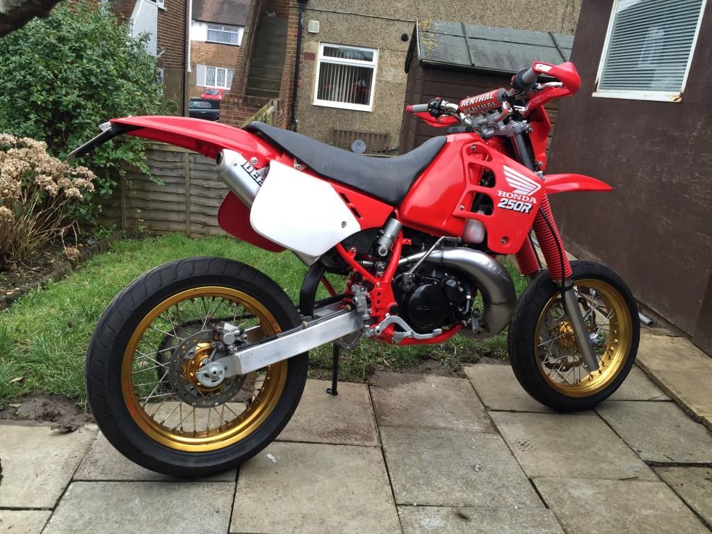

So after a busy couple of weeks finishing it off, the CRM is now complete, I started the bike last weekend for the first time however this took a few minutes as the cheapo kill switch I bought was the incorrect polarity, I have since bought another switch which is better quality & works correctly, I also had to change the pilot jet from a 48 to a 52 as the bike was very flat from tick over. The Carburettor float bowl seal had also gone hard & was leaking so I managed to replace the seal using some cut to length O rings. I MOT’d it at the weekend & it passed.
The only thing I want to change is the tyres as the ones currently fitted are about 10 years old, although there is plenty of tread they have gone very hard, wheel spins in third may be fun but cornering is not! I have now ordered a pair of Maxxis M6118 & M6119 supermoto tyres.

Post by fallenmikethebike » 16 Feb 2015, 17:04
Well done, good finished project you have there. One thing I noticed was the super high back end, has this been altered or is due to the lower profile supermoto wheels?
d5aul
Posts: 60
Joined: 18 Nov 2003, 18:19
Location: Chatham Kent
Re: d5aul's MK1 Supermoto project
Post by d5aul » 16 Feb 2015, 18:44
I think it's mostly down to the lower profile 17" wheels, all the suspension bearings are all good so there is no play, although the rear shock has a stainless steel machined shaft fitted, when the bottom connection was fitted I'm not sure if this went fully home on the shaft, it wasn't going to go any further without damaging the shaft so it's possible the shock is a little longer than it should be?

d5aul wrote:I think it's mostly down to the lower profile 17" wheels, all the suspension bearings are all good so there is no play, although the rear shock has a stainless steel machined shaft fitted, when the bottom connection was fitted I'm not sure if this went fully home on the shaft, it wasn't going to go any further without damaging the shaft so it's possible the shock is a little longer than it should be?
Yes, the extra length from the new shaft could do it. Considering that the bike is on the side stand, there's a lot of clearance at the back end. It should be OK though.
