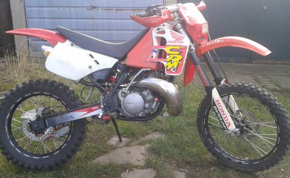

after a winter in bits its now together 'again' only got a few photos as my phone packed up all 3 were taken yesterday
black kit is the weston beach armour
faded red/white is aload of old spares kicking around
shes had new bearings all round and full rebuild apart from balance shaft as mines disconnected ;) crank case rework to add to the topend tuning, new hagon rear shock and the cr forks have had some love as well plus new clutch plates and a barely used basket ..and last but not least a new swingarm bolt that il treasure forever due to how much it bloody cost :lol:
still a bit to go but the light at the end of the muddy tunnel is in view :

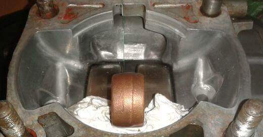

and this is the new kit (had to upload separately) and additional work to add to the 2mm oversized piston,headskim,rad valve,powerwing and topend porting,airbox mod,full fmf. Once its wore in theres a 36mm carb to play around with as well :)

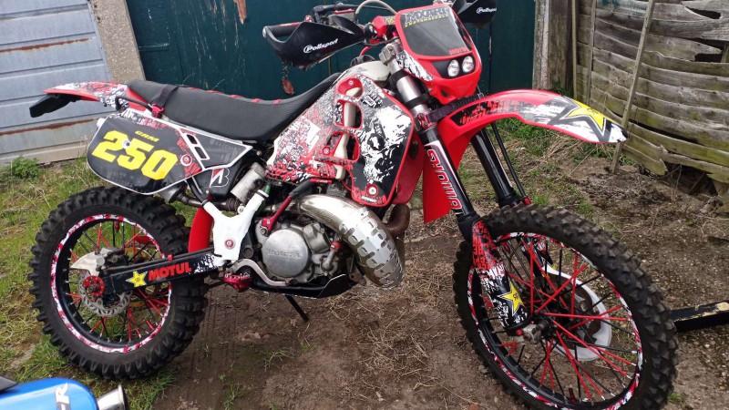

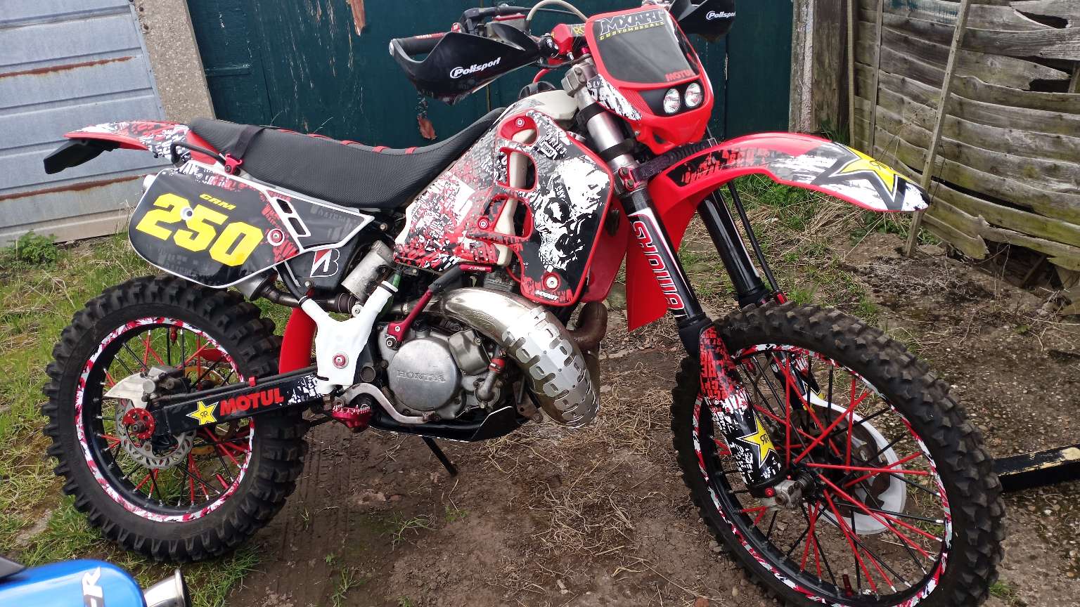

New additions are...... cr 500 seat foam added to crm250 base with a bit of cutting and filing
Cr 125/250 1989 side plastics conversion with a airbox cover made from a old lh plastic and a boiler bracket(bit of trimming required)
Custom graphic set from mxart in Australia made too requirements at no extra cost
Rare alien light from the USA and some bling bling

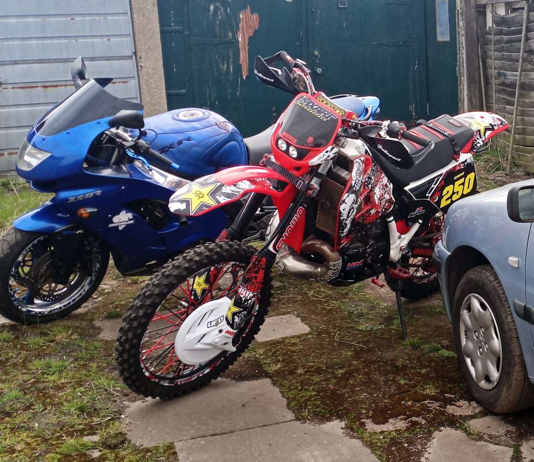

Post by pudzie83 » 07 Apr 2022, 21:43

Rear side plastics sit perfect and not like the original left hand flat and wide right set up (petty easy to do with a certain boiler bracket)
