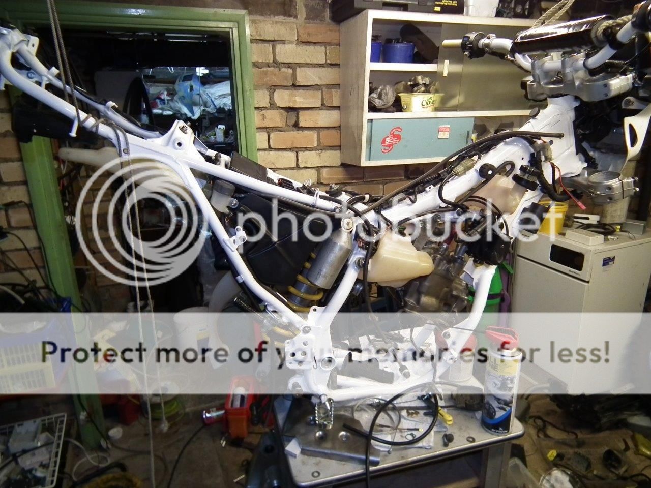

I took early retirement in April and have slowly been working my way through the jobs One of the things I was looking forward to was getting my AR looking good. The frame in particular was looking very shabby. There shouldn't be too much to do apart from cosmetics as it was running reasonably well but was very hard to start and hunting badly at tickover. I'll go over it with a fine tooth comb so will hopefully run OK when reassembled. I know it will be sacrilege to many but a year or two ago I was able to get hold of an unused original exhaust and silencer for a song. It certainly weighs a ton compared to the (very rusty) DEP that was on the bike but given my meagre off road abilities I don't need to worry about a slight loss of performance and increased weight. I also got a fairly mint original rear shocker that should do to replace my rusty/saggy one.
I finally got some free time so tore it apart this last week. These things are remarkably complex so took lots of photos to help get it back together. It all came apart OK with no snapped bolts. The swinging arm bolt just pushed out by hand as that battle took place a few years ago! Will hopefully take the frame to the powdercoaters next week. I whipped the head and barrel off and the piston has some scoring down the exhaust side skirt from a seize but other than that looks OK. The barrel appears fine as there only some very fine marks lower down. Thus, I might be able to get away with new rings rather than have the headache of sourcing new piston etc. Hopefully the pics will work as I downloaded a Photobucket access fix.
Keith
Keith

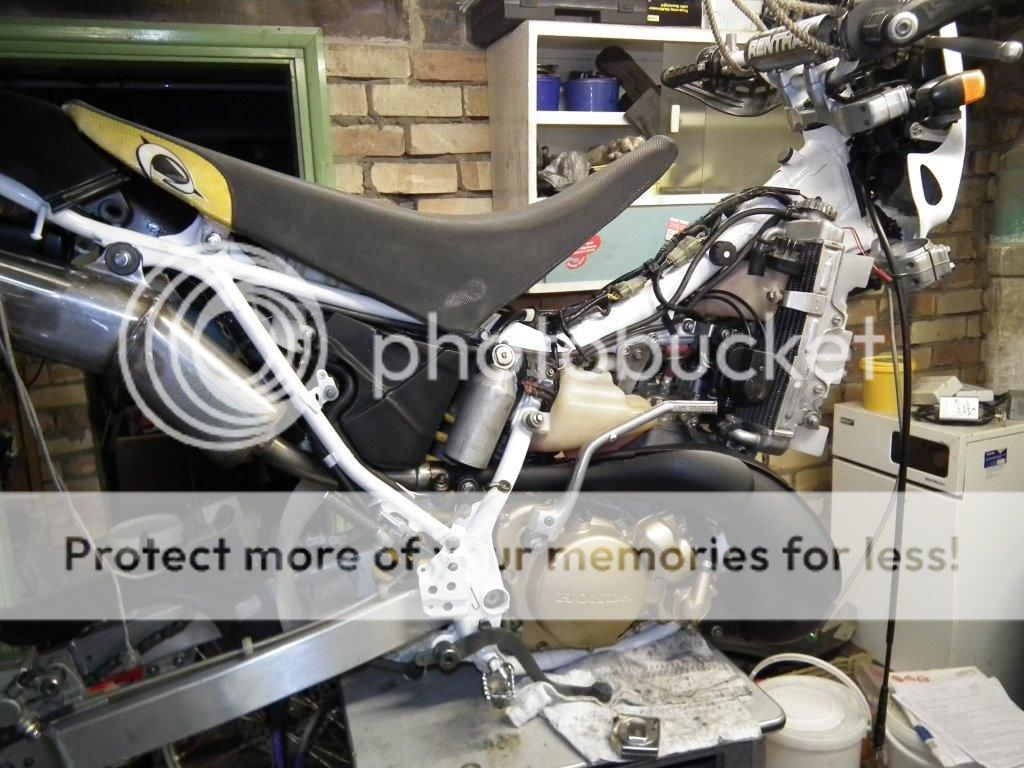

Things are moving along quite nicely. The wiring is all sorted and working. The badly damaged airbox has been repaired and now looks ok. The carb has been cleaned but it was perfect inside. Suspension bearings were all fine except for the top shock bearing that needed replacing. I now have a spare engine that has a perfect bore and piston so I will rebuild my existing engine with the new top end. I had two frayed throttle cables (the oil pump one had nearly snapped) so I made up some new ones.
Still lots to do
Keith

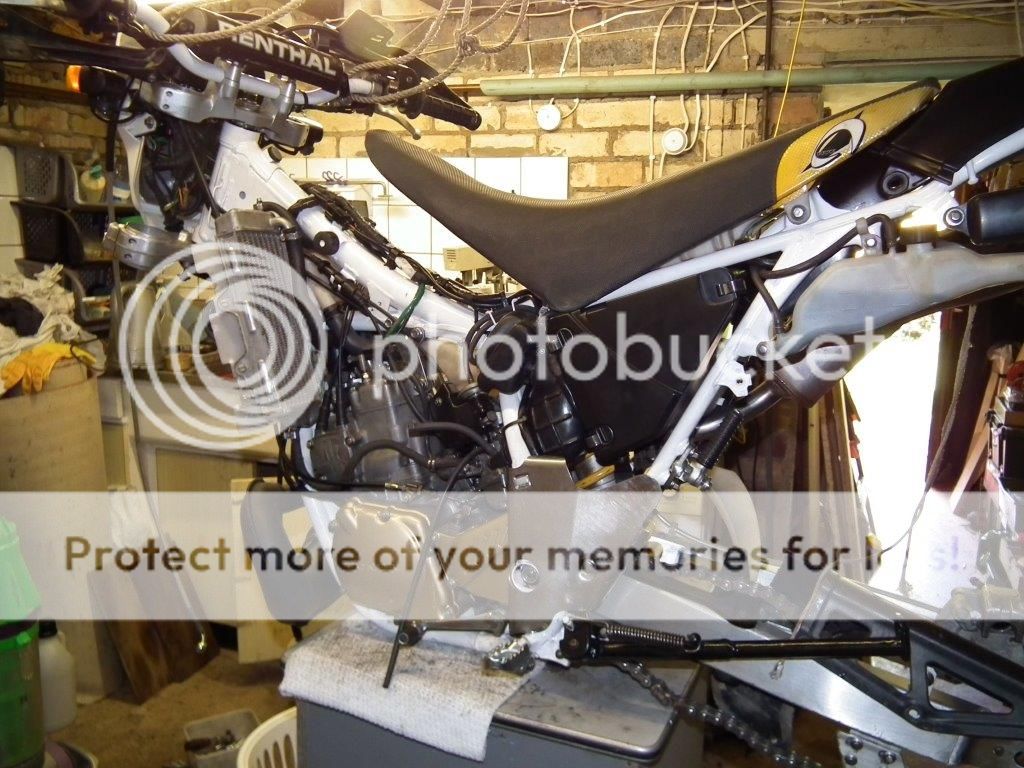

Things are proceeding nicely. The engine is now rebuilt and installed. Best of all I get a spark when its spun over which is always a big relief with an AR as there is so much that can go wrong. My engine turned out to be in great condition apart from the scored bore and piston. I didn't strip the bottom end as all appeared good after a good flush with petrol and when I did a leak down test the seals were holding both pressure and vacuum fine. There was a tiny bit of play in the balancer shaft due to some scoring on the shaft. Fortunately the one in the spare engine was perfect so that was the only other thing I had to swap. Thus, gaskets, new rings, some nice shiny stainless steel fasteners and paint was all that was needed These engines are clearly tough as both engines looked they had been used well!
Still lots to do but things are on track for late Spring.
I failed to put photos up when I tried a few weeks back. Don't know if I am doing something different or some site settings have changed.
Keith
Keith

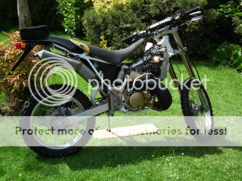

I had another go and the photos worked this time though I did have to resize first. I rebuilt the (road) wheels with new stainless spokes. However, I need to do some more Zinc plating and then I can put wheels back. I think I will use my existing fork legs for now even though the anodising on one is quite bad. I rebuilt them a couple of years back so they are functionally fine. I'll do something with them next Winter.
Keith
Keith

Looking really nice mate clean tidy work on the wiring too. I like the frame protecting plates you have on the left side, you have them made or were they always they?Gammakeith wrote:I had another go and the photos worked this time though I did have to resize first. I rebuilt the (road) wheels with new stainless spokes. However, I need to do some more Zinc plating and then I can put wheels back. I think I will use my existing fork legs for now even though the anodising on one is quite bad. I rebuilt them a couple of years back so they are functionally fine. I'll do something with them next Winter.
Keith
I'm just having my wheels re spokes with stainless spokes after powder coating , I'll pop a few pics up when I get it all back together.
Keep the pics and updates coming, love to see a good restore (no matter how big or small) !
Sent from my TA-1012 using Tapatalk

Thanks! I spent a lot of time on the wiring as there were a number of botches and frayed sections to repair and getting it routed correctly was not easy. In my experience a fair number of breakdowns are caused by wiring so worth getting it right! I have stainless steel frame protector plates for both sides (the right one is not fitted on the photos) plus an aluminium bash plate for underneath. The bike came with them so I have no idea who made them. They seem a very sensible addition!
Keith
Keith

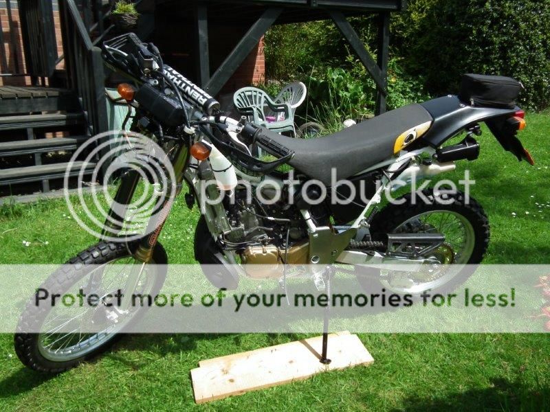

Well after a flurry of activity its pretty much done apart from dealing with the battered plastics and a quick tank respray. I rigged up a temporary fuel tank and it fired up 3rd kick and runs lovely. Best of all it now restarts easily which it certainly never used to do so I am pleased. There is plenty of time to go before I need it for the classic TT so I can relax a little now
Happy days!
Keith
Happy days!
Keith

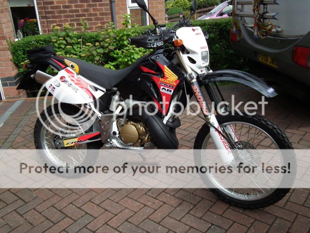

Well after a final flurry of activity the CRM250AR is finally done. Just need to get it MOT'd to be legal. A couple of trips around the block revealed a 2t oil leak (level warning switch) and an antifreeze leak - both now sorted. Even that short run on a freshly rebuilt engine shows how much better it is now running. It starts really easily and started to pop the front wheel up in third without trying so I am looking forward to putting some miles on it before the classic TT
Keith
Keith
