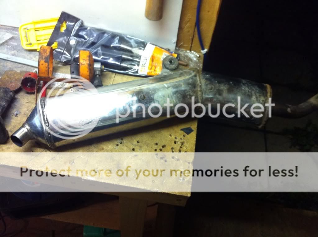

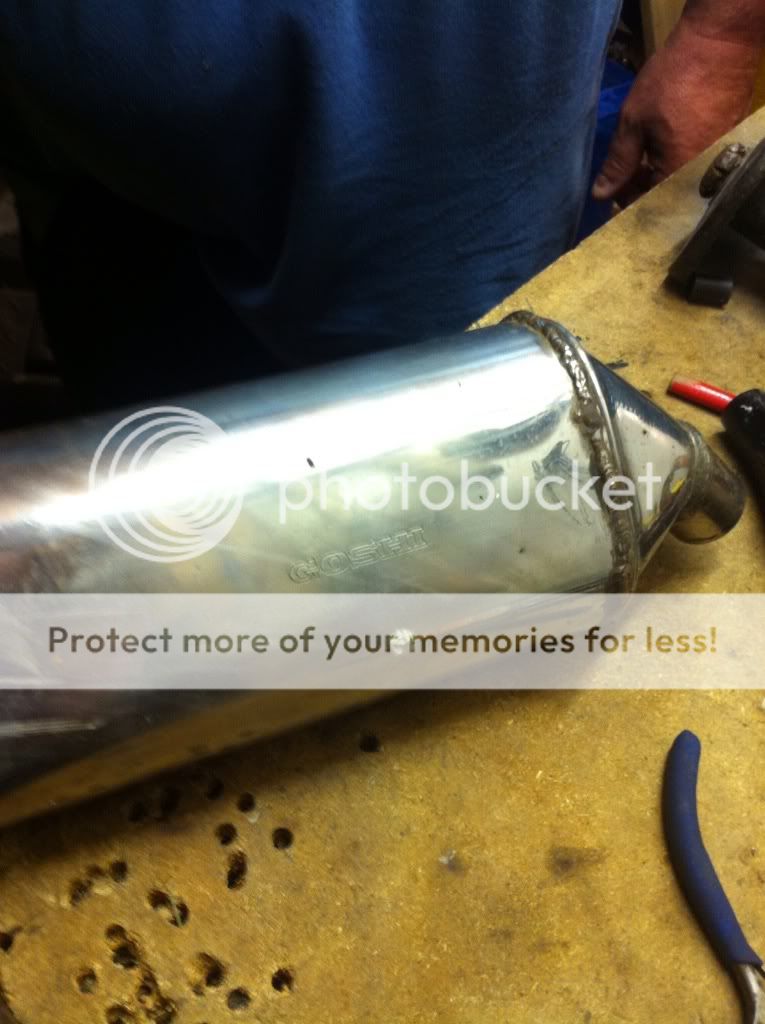

Does anyone know if I should do the same with the silencer or will it ruin it? I don't know if there is any wadding in it for example.
I am not even sure if the silencer is just the standard item, it has Honda stamped one side and Goshi on the other.
I then added a compressor into the mix when it all got nice and warm and things got very interesting. Recommend it to anyone with an interest in Jet thrust propulsion!
- Posts: 4184
Re: Cleaning the exhaust
Post a picture. If the original it might explode. If aftermarket they can be taken apart, cleaned an the fibreglass wadding replaced.
cam anyone tell me if that is the original silencer please.
- Posts: 4184
Yes it is.
