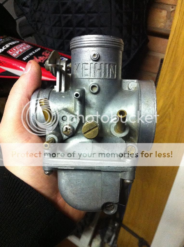

Carb cleaned
Well from this
To this
I jotted down the current set up too.
I have taken the clip up one notch, ie lowered the needle so it should run a bit leaner, will slap a new spark plug in and see how it runs.
Just need to sort out the ugly old overflow pipes with some new silicone replacement and reroute as previously advised on here, anyone go t a quick pic of where to route the stuff as I can't picture where to put them
To this

Re: Carb cleaned
FYI 150 main jet is standard.
- Posts: 115
- Joined: 02 Dec 2012, 21:17
- Bike Owned: Mk 3
Re: Carb cleaned
Thanks, that is interesting. Will leave it though as I plan to upgrade the exhaust when I can source one so upping the main jet at that point would be sensible. Of course, I may need to adjust the needle as I have taken the clip up one but suspect it was only running rich due to the main jet now I know that.

Yes it's a mark3. Although the carb bore little resemblance to the Crm workshop manual I found.
- Posts: 4184
Re: Carb cleaned
Looks the same from here.
Re: Carb cleaned
To route the breather pipe, it's at least a seat off, if you're only going to the airbox.The pipe will need to thread through the other various cables in that area. A small hole will need to be drilled, or take it through the snorkel hole.
You will know when it's right by the elegance of how it sits and looks, sorry about the description but I suspect every one's will be slightly different.
If you prefer the headstock option, it's the tank off as well. I took mine up along the underside of the main spine, then through the head stock gusset, with a filter on the end of the pipe, to help keep the cr@p out.Again when it looks right, it invariably is right.Whilst under the tank, [if you do] check the twin pull throttle/autolube connector.This often gets overlooked, my preferred course of action is to carefully drill small a hole in the bottom of the housing, just enough for a WD 40/ ACF50 straw, then fire some in there, any surplus will find it's way out again through the drilled hole.

Re: Carb cleaned
Maybe I have a diff workshop manual then.
Thanks for the information, will take a look and try to visualise. I can't remember what pipes go where in standard guise at the moment though!
Re: Carb cleaned
The two on the slide body, take upwards, link together above the carb, then to air box ect.
The single one of the float bowl, take downwards.
The water heating pipes should be self explanatory.

Re: Carb cleaned
There are three clear pipes of the carb, the lowest one [1] leading of the float bowl, is the overflow for the carb. This must go downwards otherwise carburation can be effected. The two [2]pipes higher up the carb body, on either side of the slide chamber, you can, if you so desire take them to either of the two positions I mentioned. Of course they will work perfectly fine where Mr H designed them to go, but in general it's agreed they are more likely to get munged up, or ingest water in that position, but I stress, this is strictly I.M.O.
