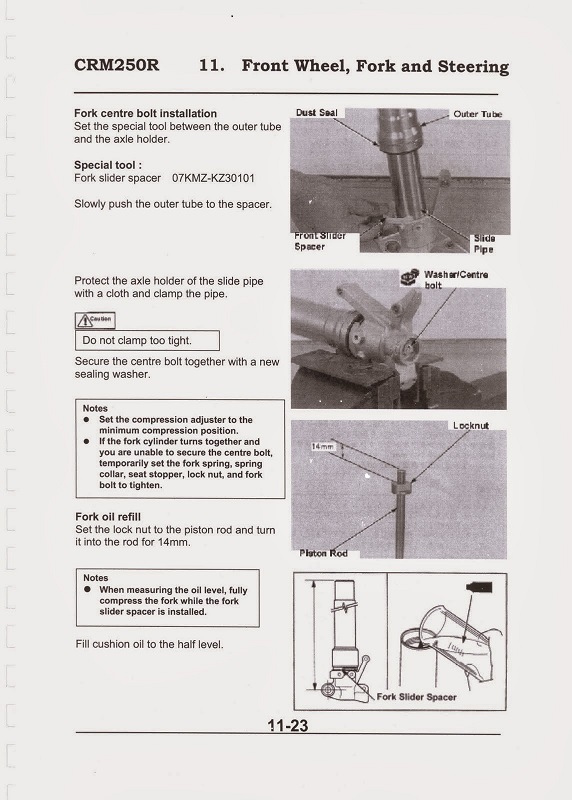

I am doing a seal replacement on my forks and looking at the manual there is a special tool
(front fork spacer 07KMZ-KZ30101) can anyone tell me the dimensions of said spacer ie thickness.

Post by frostoff » 10 Aug 2017, 21:29
cheers guys apparently you need one when topping up the oil.

Post by gregorious77 » 10 Aug 2017, 21:34
Typical Honda over engineering things. Its 2mm ffs. Who is measuring their fork oil level to that sort of accuracy in the first place. Also it sits against the dust seal which is rubber not a solid stop.
