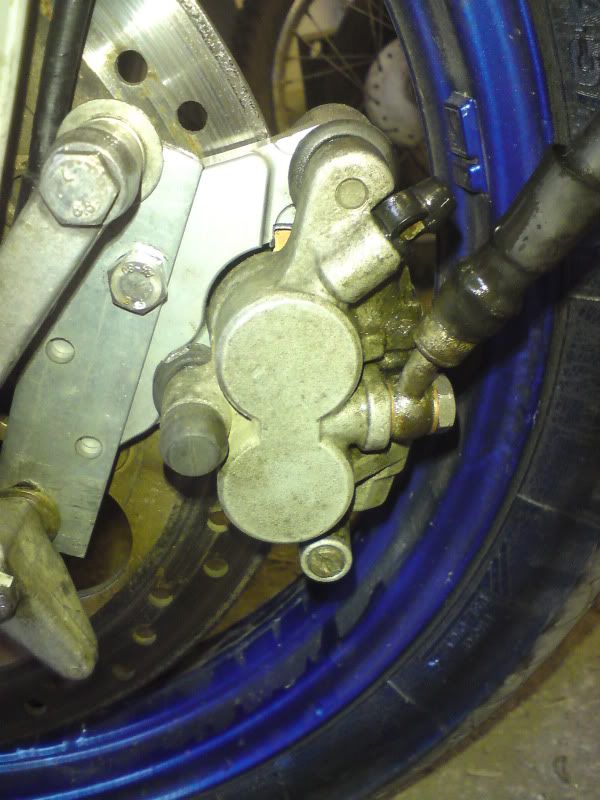

Just to double check, is this a crm or an nsr calpier?
http://i5.photobucket.com/albums/y189/j ... C00097.jpg
Its kinda looking like I'm gonna have to pay a mechanic to look at the brakes as I cant figure it out

IMO, that looks like a mk2 calliper.

Re: Need a brighter headlight
Regarding the photo - Is that builder's galvanised section being used as a bracket

[quote="knackeredMk1"]Regarding the photo - Is that builder's galvanised section being used as a bracket :?: .[/quote]
Not 100% sure what the bracket is as I bought the bike like that.
Thought it may be a mk 2 caliper. Seems pretty similar to how I bleed the brake then.
Maybe something is wrong with the caliper. It might be best for me to get a secondhand front brake assembly

WOA!!, good spotting Steve, yes , that's defo 25 mm x6mm section strapping bar.knackeredMk1 wrote:Regarding the photo - Is that builder's galvanised section being used as a bracket.
Err, that would be slightly worrying, what did the guy think. Would be ok, on things that weren't on show.
There's all kinds of things wrong about that bracket and the various packing washers and bolts used. What size is the disk
. If it's the standard SM size (can't remember off the top of my head
320mm
) then you really need to get the correct caliper bracket off Talon - TB06 and get the right sized flanged bolts.
yeah its a 320mm disk.
I think I will get the right bracket to be honest. will that talon one fit with the caliper I have? As the bracket on my caliper looks different to others I have seen.
Don't think thats whats making the brake spongey though.
Anyone got anymore ideas with regards to the spongey brake?
