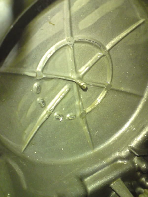

Right I've stripped the engine casing off, well as much as I can without taking apart the 2 stroke pump. And it looks as though a part of the engine casing may be broke, here are a couple of pictures I have taken.
http://i5.photobucket.com/albums/y189/j ... C00078.jpg
http://i5.photobucket.com/albums/y189/j ... C00079.jpg
Has anyone got any pictures of the inside of the casing so I can see what its supposed to look like?

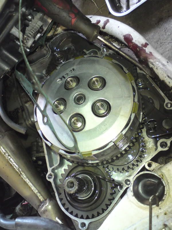

Right I've taken the clutch apart and noticed the nut was loose. So my mate is coming over later with a impact gun to tighten it up. Clutch all looks good in there though, so this should solve the problem. I did notce that the water pump shaft cog is missing quarter of it though. Is it just leisuretrail to get one of these or does anyone have a spare one?

Post by knackeredMk1 » 13 May 2010, 19:49
There should be a tab washer to stop the nut coming loose. (Depending on which nut we are referring to :roll: ).

If there is not a crack in the case towards the top of the 'circle', around the edge of the 'circle', in the first photo then I can't see anything wrong :?: .
Water pump shaft is pn - 19240KAE870. Current Honda price is £43.27 ex VAT. I have one out of a Mk2.2 that I have taken apart for spares, but it is not in very good condition.
Wear on end of shaft and two teeth have some damage. If it will get you out of a hole then £2.50 for the postage :?: .
