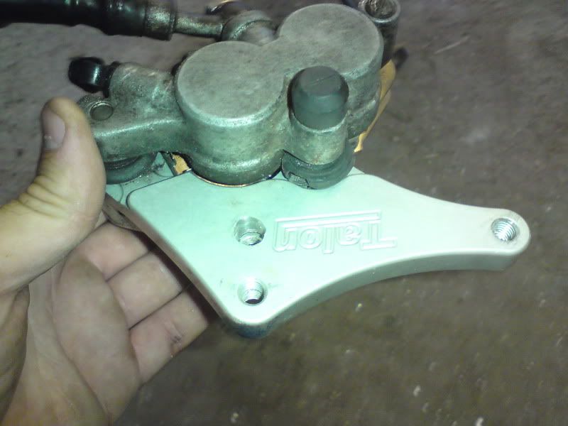

Thanks for that voodoo, I found a crm 250 thats breaking online and hes gonna post me the caliper and whole assembly for £35.
I have taken my caliper off its crappy mount, and it has a talon bracket on it but it is a TB16 bracket, which seems to fit the caliper I have right. So im guessing the caliper I have at the moment is not a CRM one. Heres a picture of it so you can clearly see the bracket ( please ignore the hole near the N of Talon, as obviously that shouldn't be there )

Post by knackeredMk1 » 29 May 2010, 20:01
The photo of the caliper is not a CRM one.

Re: Need a brighter headlight
Post by knackeredMk1 » 29 May 2010, 20:52
Sorry I meant the caliper bracket :!: :oops: :oops: . The caliper as far as I can tell is correct for a CRM :roll: :oops: :!:
