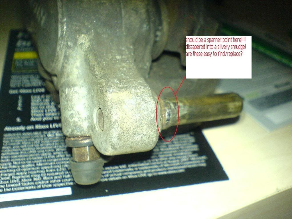

i'm a bit confused, the part you have circled shouldnt need to come out at all
this part shoul slide with the caliper.

Er me to that's the floating part of the caliper[goes into a greased rubber housing on other part of the caliper].Jonorow wrote:i'm a bit confused, the part you have circled shouldnt need to come out at all
If you want to remove the piston in the caliper, the easiest way is pump it out with the lever, or use a grease gun or as a last resort an air gun (ON LOW PRESSURE!!)
Jon

ya i know it dont need to come out i just posted a pic of the other mess
sry for the confusion

As for that pin in the photo, are you sure you need to remove it? it looks like the caliper slide pin, and can stay in.

i think i should put a descriptoin with my picsNaBz wrote:ya i know it dont need to come out i just posted a pic of the other mess
