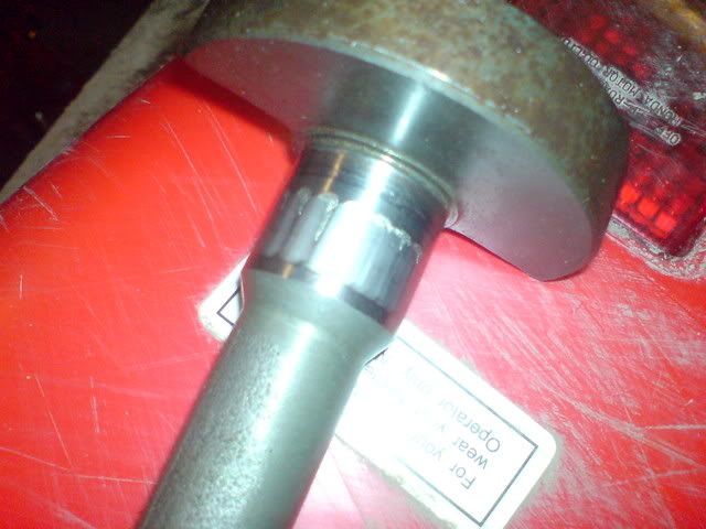

Re: Loud engine noise
This shows the wear in the balance shaft it is no wonder the bike was making such a row.
SNAP, i have one exactly the same, luckily i had a spare so changed it. There is one on ebay at the mo, so might be worth buying that rather than a new one. Jon
