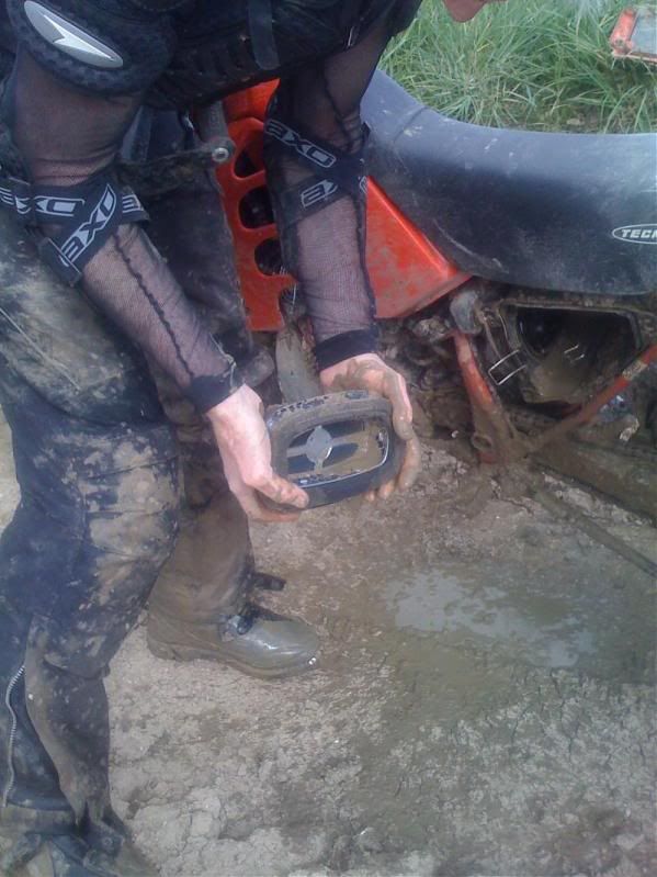

I'm beginning to wonder if all that muddy water going through the engine when I drowned it last week could have damaged the crankcase seals. There was mud on the plug when I took it out to try and get it running again and this was the state of the airbox.
<img src="http://i14.photobucket.com/albums/a340/ ... rymud1.jpg">
[IMG]http://i14.photobucket.com/albums/a340/ ... rymud1.jpg[/IMG]
