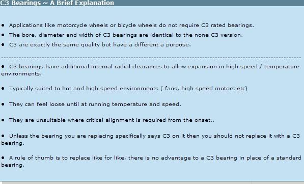

See - http://simplybearings.co.uk/shop/p146/6 ... _info.html.
Run the mouse over the 'C3 explained' for explanation
. I would think that both or neither would be suitable but maybe not a mix
. Don't really know
EDIT - Second thoughts - 'It says don't replace non-C3 bearings with C3 bearings'. So it's the wrong bearing definitely.
Re: Main Bearings
Thanks Mike, that is an useful website. Their explanation on C3 confirms that they can feel loose until running at temperature, I now wonder if the other would benefit from being a C3 as well.

C3 Text -
