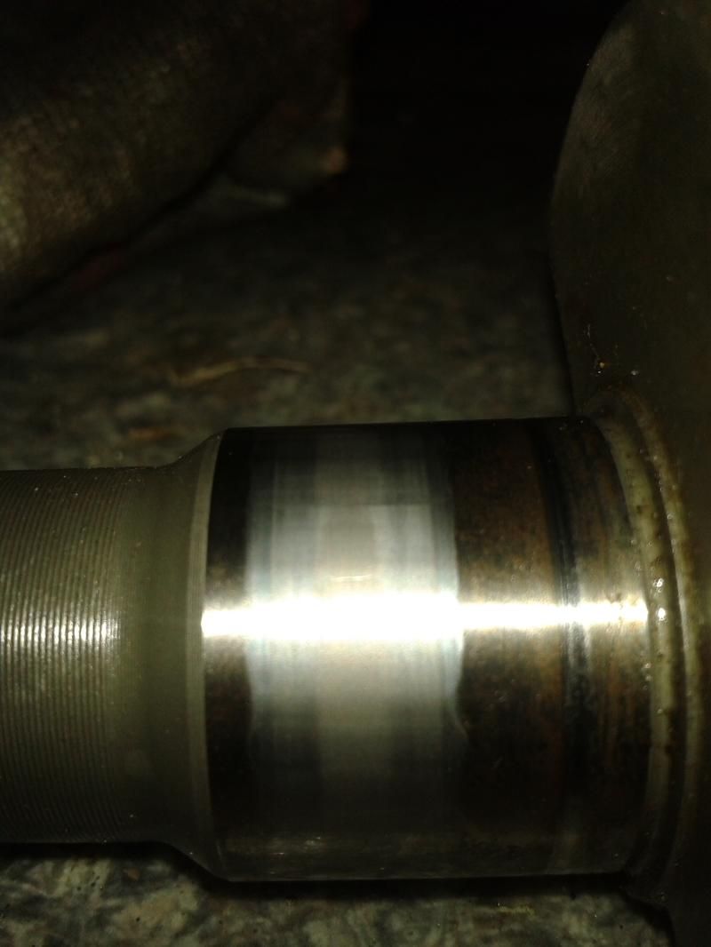

@2stroke
See links for pics of worn shaft.
http://i71.photobucket.com/albums/i147/ ... 143504.jpg
http://i71.photobucket.com/albums/i147/ ... 143454.jpg
The wear will be worse on the weighted side for obvious reasons. Mine is rippled and can be felt with my finger.
