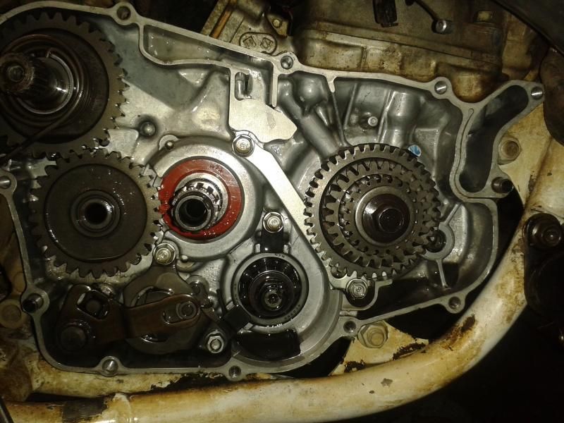

So the removal of clutch and new spacer on balance shaft was a breeze with a rattle gun as this was the 2nd time this week that I have done this job.
Next stage was to remove the balance shaft, oil seal and bearings.
Generator cover off - easy.
Shaft out - easy (looks worn on one side as I expected).
Clutch side bearing out - little fiddly getting the gear selector stuff out the way but no biggy.

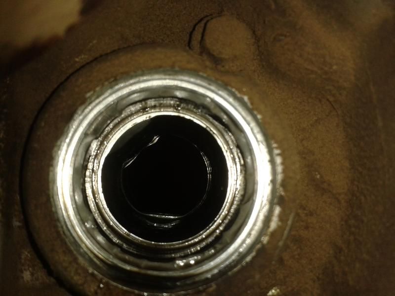

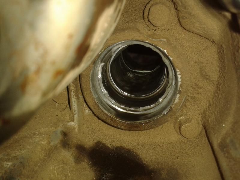

Generator side bearing - nearly ended in me torching the bike and claiming the insurance!!!!
I used a socket that just fit through the tunnel to the other side to persuade the bearing out but what actually happened was the bearing sat itself and the front lip broke away piece by piece until there was just a lipless outer race left with no way of tapping it out from the other side!!!!

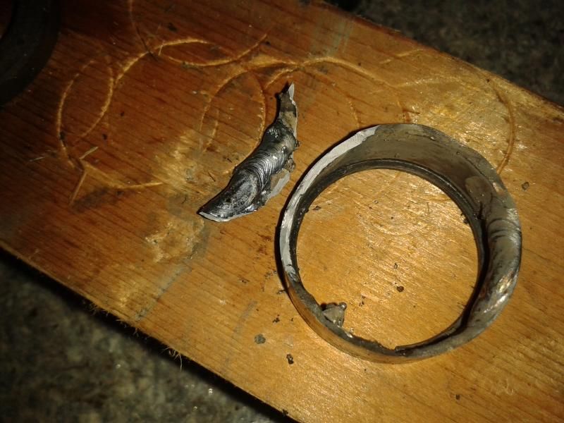

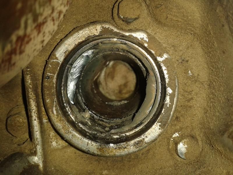

In the end I had to get the MIG welder out (steering bearing trick) and lay a couple of beads on the race so it would shrink a bit on cooling and I had something to hit with a drift from the other side.
Still didn't want to give up easily. I guess it was happy in there.
all out finally ready to get new bearing and shaft fitted.

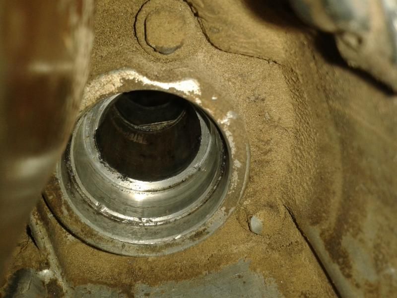

Been there, bought that tee shirt, done two of them bearings, TIG welded a M12 dome nut to the edges of the bearing housing, screwed a M12 studding through the engine, one swift firm tap with the hammer they dropped out, best done with engine out of bike and help from Rich1960.
