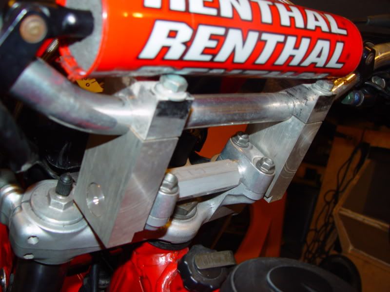

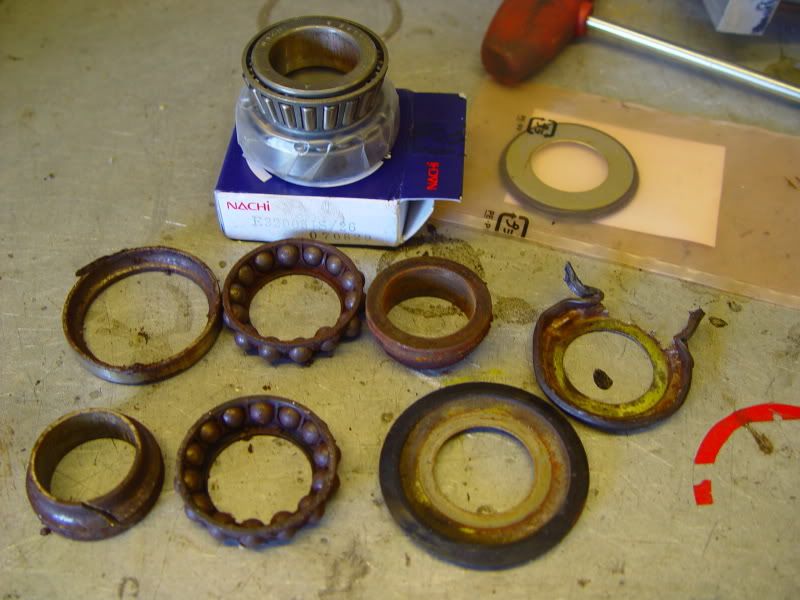

I've only ridden it round the garden so far as I had to do a very small amount of work on it, like replace the headstock bearings and front tyre, fit my homemade risers I made for the KLX, and generally give it a going over.

Those head bearings are probably the originals as everyone changes to tapered rollers when they need to be replaced
Seat has been cut down a lot - you might want to take it back to original as it will make moving about the saddle much easier

Hello and welcome ,I like the bar risers good idea.

[quote="MarkF12"]Hello and welcome ,I like the bar risers good idea.[/quote]
Thanks Mark, I need them, I'm 6'6"
