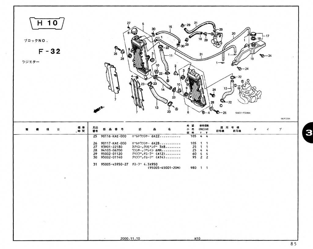

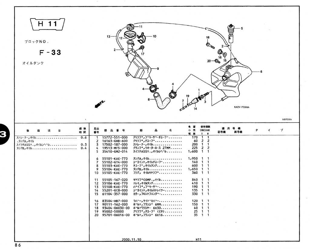

which bike? you say bottle next to rad. on the AR this is the 2 stroke oil bottle not the expansion bottle.
I dont know about the other mk's though. the expansion bottle is under the rear left panel.
It says oil on the lid. do not fill with coolant unless you want to kill the engine.
Coolant Diagram (AR)
2T oil diagram (AR)
2T oil diagram (AR)
