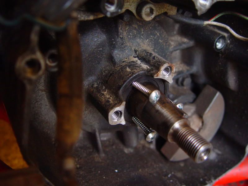

Well after working on it till 11.30 last night I've decided on a rebuild of the engine. I started to remove the seal on the gennie side of the crank in the usual fashion, with self tapping screws, easy enough:-

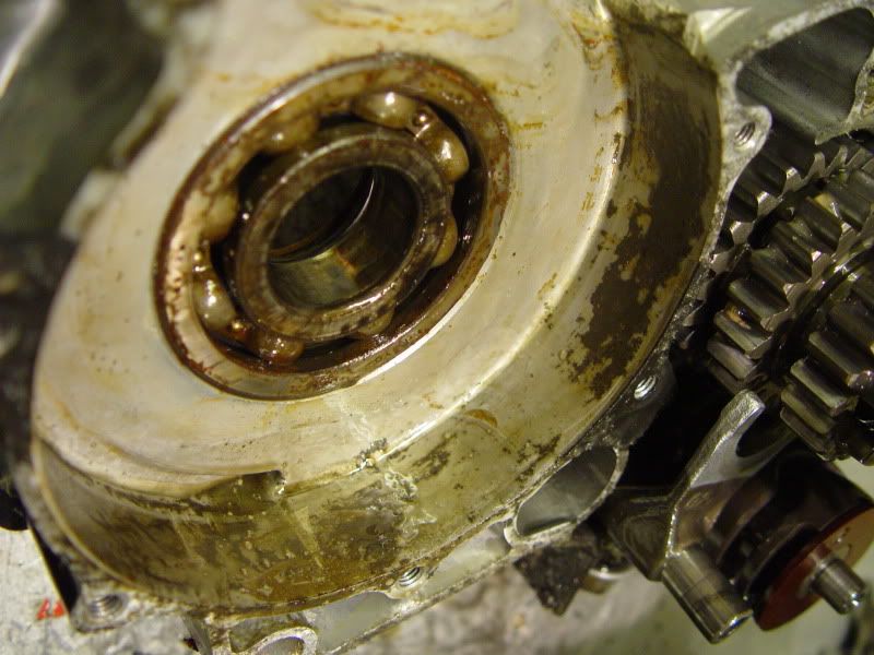

So I hoiked out the engine and split it to find this :-(

That'll teach me to take it swimming in muddy pools ,,, or not,,, prehaps,,

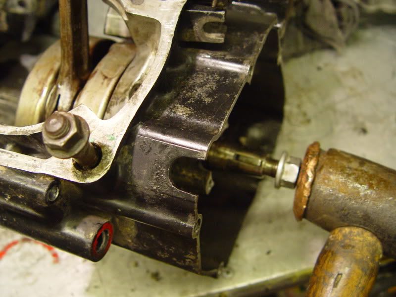

No amount of whacking it with a copper mallet made the slightest impression and I was getting worried about damage so decided to leave it at that for the night.

Finally got the crank out of the R/H case. Rested it on a Black'n'Decker workbench with the flywheel poking though the gap between the jaws and used a sledge hammer with a big lump of copper placed on the end of the shaft/nut and with very gentle at first blows, increased to quite heavy thumps it started to move and finally fell into my waiting hand.

Yeah I did wonder about all that crap on the flywheel, only on one side?
Was that down to my taking it swimming? Were the bearings already on the way out anyway? Did I simply exacerbate an already failing set of bearings?
If so, then I'm glad in a way that I did shag the seals by doing so as I have at least discovered that it all would have gone bang at some stage soon and would have likely had a much bigger bill than I already have.
