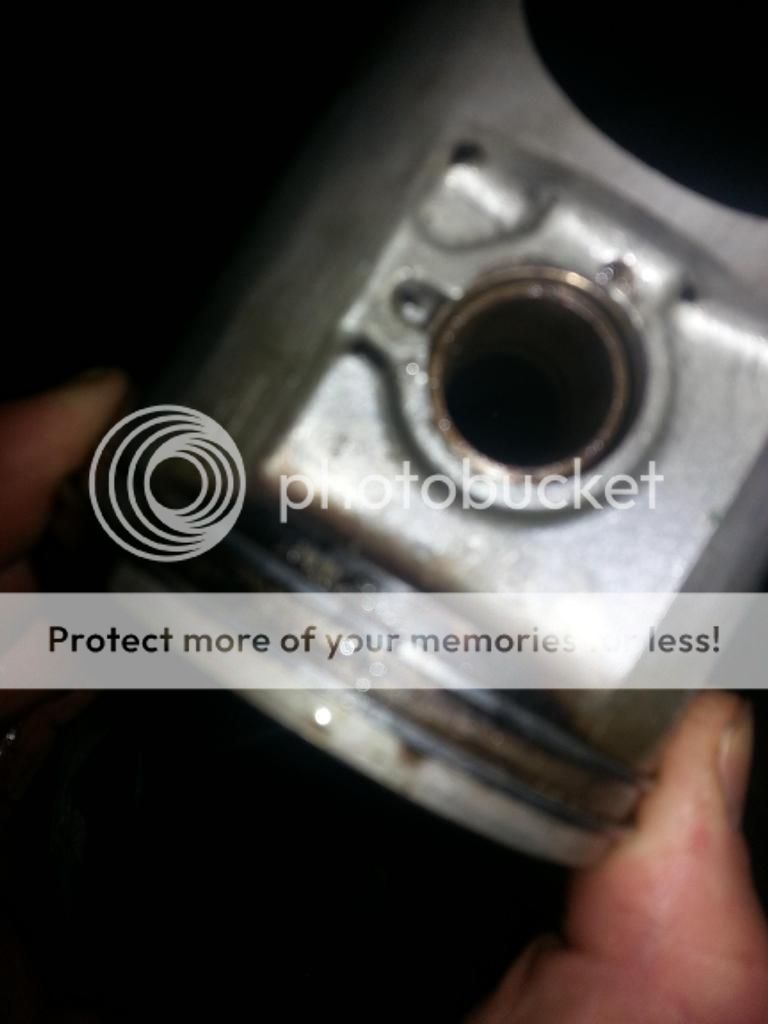

So guy's, an update. I have removed the head and piston, here are some images. I don't know what I'm looking for, however I'm pretty sure the piston shouldn't be the colour that it is?
I am taking it to be inspected by a motorcycle mechanic but any advice I can get here would be very welcome. Thanks in advance.

Re: Can't start my CRM.
Post by knackeredMk1 »
A few things -
1) I'd like a closer look at the inside of the head please.
2) Can't really see but your bore doesn't look bad but it could be just worn without any major scars. How many hours has it done since the rebore? If you run your finger around the bore, particularly in the top cm can you feel any ridges or lips?
3) The piston top is fine but there is a bit of 'blow by' past the rings. The black carbon deposits should not go much below the lower ring on a well running engine. It could be that the rings are worn or the bore is worn. I've also seen, but I'm not suggesting this has happened, the wrong sized piston put in. In the case I found there was a standard piston (66.0mm) put into a 0.75mm overbored cylinder :shock: . It ran, and had been running like that (with a bit of piston slap) for at least 6 months before I found it.

I don't know how many hours since the rebore, I haven't had it done since I took over ownership about 8 weeks ago. I can't quite reach to the top of the bore with my fingers but can't feel any ridges or lips.
I know that the piston was brand new last November.
How do you identify if the ring's are gone?

Closer look at the piston:
http://i977.photobucket.com/albums/ae25 ... cc5566.jpg
http://i977.photobucket.com/albums/ae25 ... 9d593a.jpg
