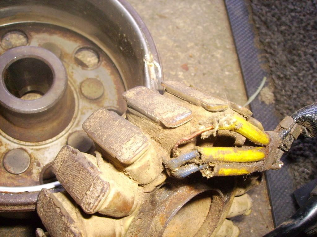

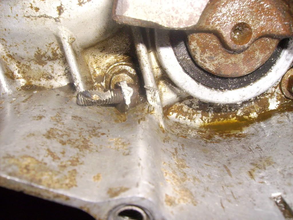

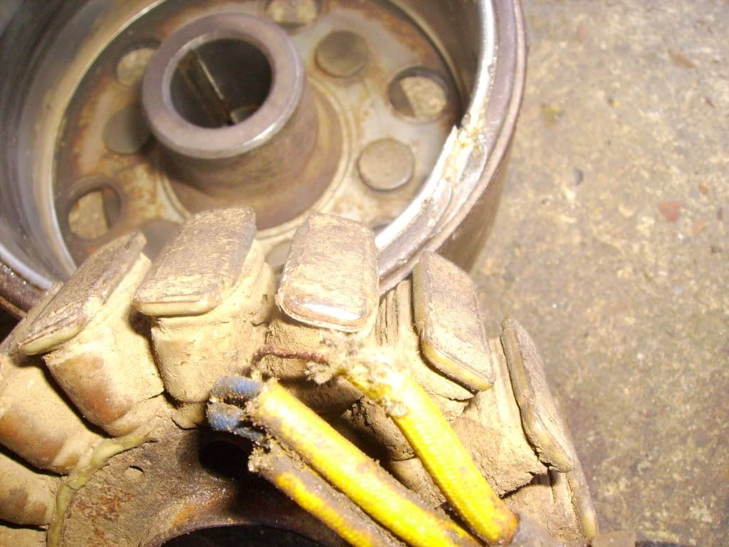

Hi Guys
can anybody help with advice and or parts.one of the pulse generator bolts has worked it's self loose from my AR , it took a chunk out of the rim of the fly wheel/magneto.first signs of the problem were poor starting and would only start with a push when hot.cranking it by hand there is no spark to be seen and it will no longer start by kicking but did with a push.
I don't know what other damage has been done yet as the allen bolts holding the pulse generators wont come out stopping me from fully removing the stator.the loose bolt ended up jammed in the casing behind the balancer shaft weight.I have done a search but none of the problems seem to be physically damaged ones.
Many thanks
Silver Fox

That sounds pretty bad tbh and never heard of that before. has the motor been rebuilt ? if so by whom and when. can you put pictures up so we can see the extent of the damage ?

I have rebuilt the engine myself so hold myself responsible.could a heavy wack on the magneto reduce the effect the magnet has on making enough power to start the bike with the kick start ?
My first attempt at uploading pictures,hope it works.

As far as I'm aware it can only be two other problems (unless your bike has developed faults outside of the area being discussed).
1). Coil is broken. Can this be tested for resistance
2). One or both of the pickups is damaged. Quite likely for at least the one that's been whalloped
