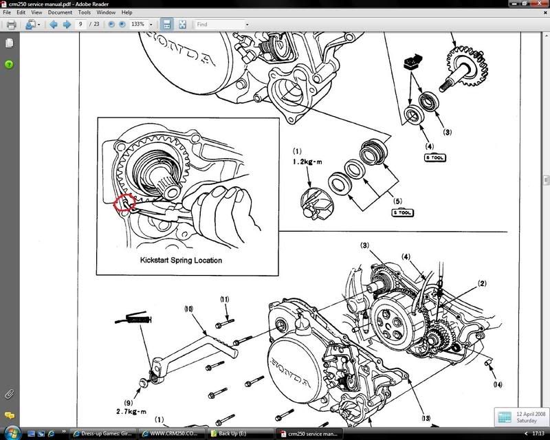

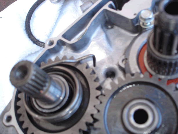

just bolting the bike back up. I've just put the kick start mech back with the large spring placed on top.
Where does the edge of the spring need to be? it looks like it needs to be placed in a hole or something
in order for the spring to work and eneable it to wind and spring back but I Can't seem to see no obvious place for it.
I just looked at the back of the clutch basket also - since this sits on top and obscures it.
Re: Kick start spring.
Cheers Nabz
When in doubt.. RTFM!
Dident think it would be in the workshop manual for some reason.
make sure the dots on the kickstart shaft and the gear linbe up before you fit it too! or your kickstart wont work once its back together
I noticed that in the manual and was looking for the dots for quite a while, but couldent see any. Maybe because I removed and installed the whole mech at once as appose to individual components? Or am I being blind again?
