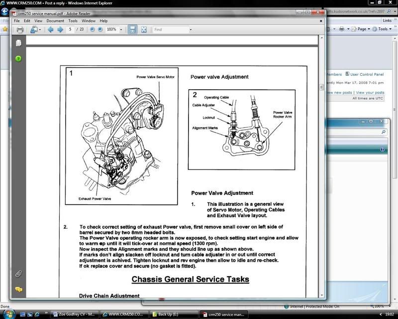

Looks like i'm going to have to strip the power valve. :eek:

Re: AR
Post by NaBz »
if you aint coming off you aint riding hard enough!

Re: AR
Post by scrubs »
Hi Frostoff,
I have just seen this post after your reg/rec testing thread. This is the same problem I had
when my Cdi was on the way out. If you take the cover off the power valve arm
you will most likely see that the power valve works sometimes and sometimes not.
for instance -- it will be working fine until you turn the engine off, then the power valve
might not function at all the next time you start. Mine went on working intermittantly for a
few weeks before it stopped completley and no matter how many times I switched on and off the ignition
it failed to revive. If it is a Cdi problem I'm afraid there is very little you can do to be honest - it will stop working eventually. The only other possibillity could be loose wiring, check and clean all plugs and connectors. when the powervalve
isent working - try giving the servo motor (the black plastic box behind the right radiator) a few light taps with
a spanner to see if it springs to life. This would suggest a prob with that and if it is more tests can be made to
it to determine what is wrong with it.
